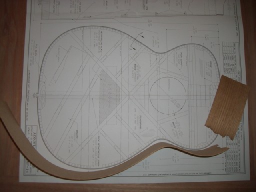

things i will do differently next practice run:
1.  possible work indoors (if the wife smiles on it ) as the temperature is a bit warmer and the humidity probably lower.
2.  after the bend is complete, cook the side for twenty minutes or so at a lower temperature to dry things out.
3.  probably use foil and craft paper this time. i just realized that on the second side i bent (the worse of the two), i wrapped the side comletely in foil with no way for moisture to escape.
anything else?
as for bending with a hot pipe. i gave it some thought and then decided on the heating blanket. i figured i would probably end up using a blanket eventually anyway, so why not just start with it? maybe it would have been a good idea to get started with a pipe, but since im $200 deep on blanket/slats and hours in the shop making molds and forms, i think ill stick with my current method. thanks for the advice though.

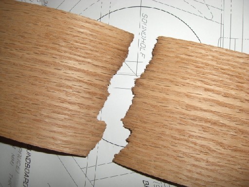

well, this is my third try. it seems like im getting worse with each attempt. not sure what to do now. guess ill try again, eh?
sweat the small stuff.
PostPosted: Mon Oct 22, 2007 4:46 pm
Posts: 783
First name: Kirby
If you were bending using a pipe I would be telling you wait for the wood to relax that you can feel it when it does.
Not having form bending experience limits my ability to help.
It does sort of look like you bent the waist first and cooked the bouts dry before you got to them. It is easy to be wrong just looking at a pic though.
I think you should describe the order of operation and a rough time line.

    I suspect you may be doing one of 2 things , One you may be waiting too long and not getting the heat you need or overheating.
   If you case harden the wood , and this means you over cook and over dry it you turn the wood very brackish and it will snap.
   Another thing is that you may not be working the wood as you should. If you are just pulling the ends you can brake it , I like to use the hold downs and roll the wood onto the pattern.
   The total time in the actual bending process should be about 6 minutes. Todd describes bending perfectly
Just in case what is your heat? 325 is a good all around temp
john hall

you guys are just too cool. thanks so much for the response. well, this time around my sandwich was from top to bottom: blanket/slat/foil/parchment/oak/parchment/foil/slat. lightly misted both sides of wood prior to wrapping it all up. turned blanket on full blast for about 3 or 4 minutes prior to starting bends. temp between blanket and first slat was around 320 when i started. bent waist first, stopping about 1/2" shy of full bend. next i bent the lower bout, then moved on to the upper bout. the entire process took about 6-8 minutes. i then cooked the side for about 20 minutes at around 290 degrees. the whole thing cooled for a few hours. then i went back outside and cooked again for about 10 minutes at 290 degrees. brought everything inside and it sat in my house (45% humidity 70 degrees F) for 12 hours or so then i took it all apart and wept. ok, i didnt weep, im doing great, but i was a bit bummed. itll be that much sweeter when i get it right!
the three sides ive bent, i havent realy seen any steam rising and have not heard a whole lot coming from the sandwich. more water maybe? i KNOW it got hot enough this last time. maybe too hot. anyways, im off to read john hall's tutorial on bending. maybe ill give you a ring john. thank you so much for the offer.
after my first attempts and all the spring back, i thought for sure more heat and longer period of heating would eliminate all of the spring back in the wood. even if the wood had not cracked this time, there is still substantial springback. whats the deal?
